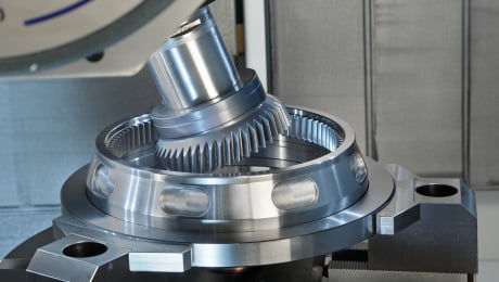

PITTLER T&S – Power Skiving: Flexible and effective production of internal gears
dvstechnology news Image
The process with the somewhat cum­bersome title of “method for cut­ting gear wheels using a cutting tool similar to a gear wheel with cutting edges on the faces of the teeth” in the patent application more than 100 ye­ars ago has matured into one of the most economical gear cutting techno­logies around – power skiving.
The inventor, Julius Wilhelm von Pittler, intended to use it to make rings with in­ternal gearing. Yet it was only with the technological accomplishments of the 21st century that PITTLER T&S GmbH were able to realise gear cutting machines on the ba­sis of the PV series for the efficient produc­tion of ring gears, for example. All those years ago, Julius Wilhelm von Pittler was forced to link all machine movements me­chanically. It wasn‘t until intelligent soft­ware and a computer-controlled numeric control came along that it was possible to move the five axes extremely precisely and synchronously to one another in an inter­polating way. Developments in the tool segment such as more sturdy powder and carbide alloys as well as high-performance coating for tools also played their part. Due to a lack of efficient production tech­nology for internal gearing, spur gears and external gearing became establis­hed in drive engineering in the course of the last 100 years. In the field of internal gearing production, the methods shaping and broaching were the order of the day. Yet this has all changed thanks to the latest developments in the field of power skiving technology. This technology allows manufacturers to get round the disad­vantages of the competing processes and benefit from increased flexibility and higher output at the same time.
Production of internal and external gearing in one clamping
Unlike shaping, power skiving is a continu­al hobbing manufacturing process which avoids the unproductive stroke and remo­val movement. The advantage: machining time is reduced by at least the factor 3. In addition, power skiving is much more fle­xible than broaching, because the machi­ne operator can configure the dimensions such as the two-ball dimension using the NC control. Helix angle and the flank sha­pe can also be modified using the NC con­trol. The high adaptive capacity becomes clear when it is born in mind that gearing can be cut both internally and externally. In the case of external gearing, the tech­nologies of power skiving and hobbing are competing more and more often. Since significantly less space is required for the tool outlet for power skiving, the techno­logy is opening up new possibilities for de­signing cost-saving gearbox components. Even workpieces with constraining con­tours can be produced efficiently using the power skiving method.
